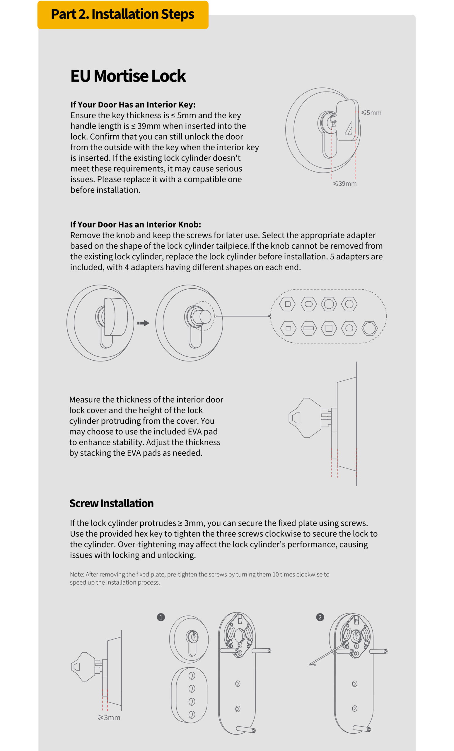

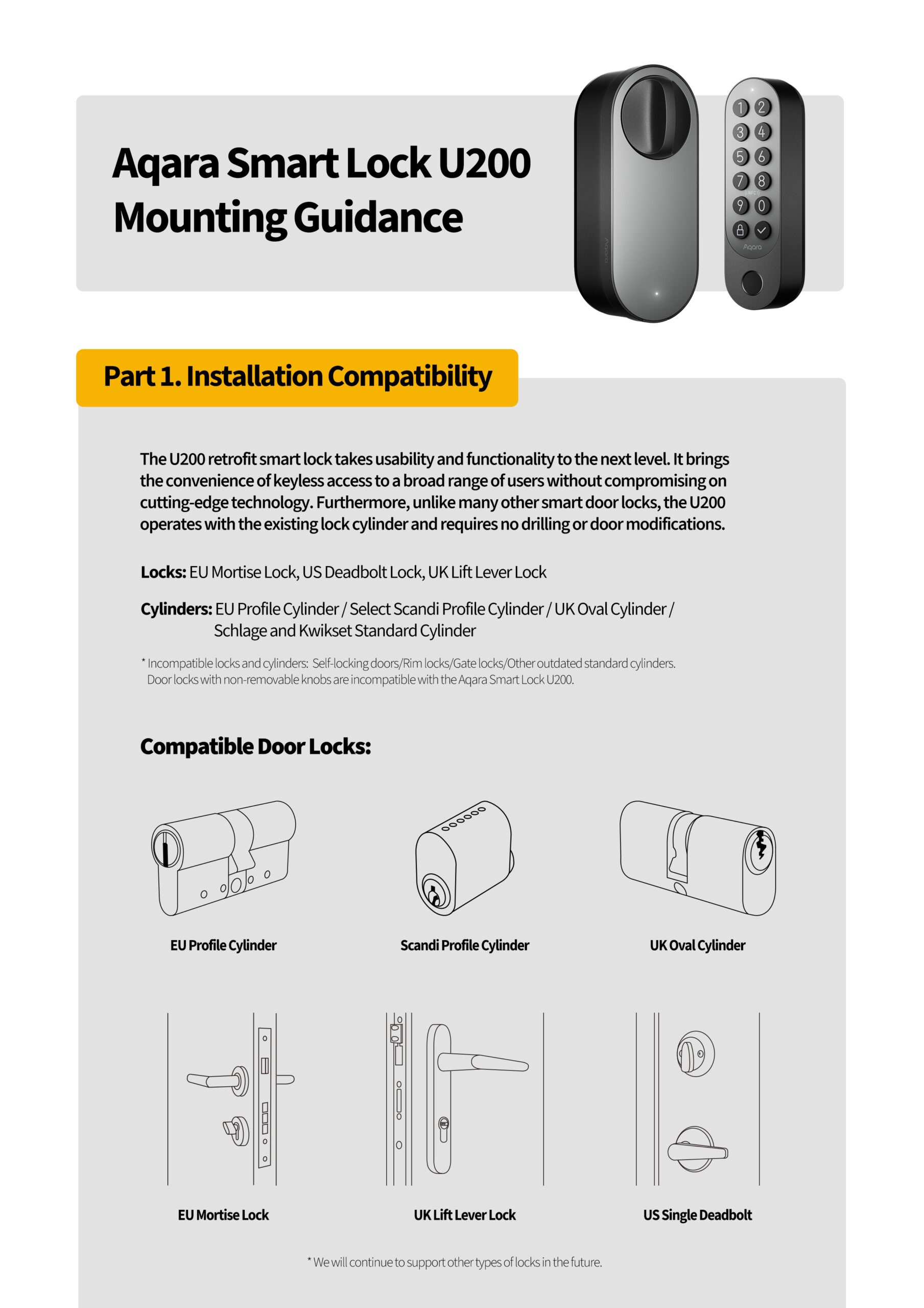

Compatible Locks: EU Mortise Lock, US Deadbolt Lock
A cylinder equipped with this feature enables it to be unlocked from the outside using a key, even if another key is already inserted on the inside. The U200 is specifically designed for compatibility with cylinders that offer this capability.
Self-locking locks/Rim locks/Gate locks/Other outdated standard cylinders
Yes, if your lock cylinder does not meet the installation requirements, consider the Aqara EU Profile Adjustable Cylinder, expected to launch in July 2024.

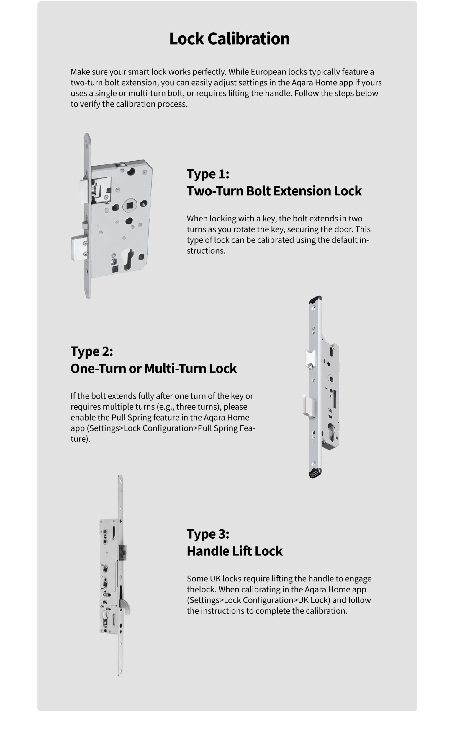

1) For Aqara Home Users:
Option 1: Go to “Settings” > “Calibrate Lock” in the app and choose either “Automatic Calibration” or “Manual Calibration.”
Option 2:  Long press (3s) the Set Button in the Door Lock for auto-calibration.
2) For Matter Users:
After installation, press and hold the “Set” button on the Lock for 3 seconds to initiate auto-calibration.

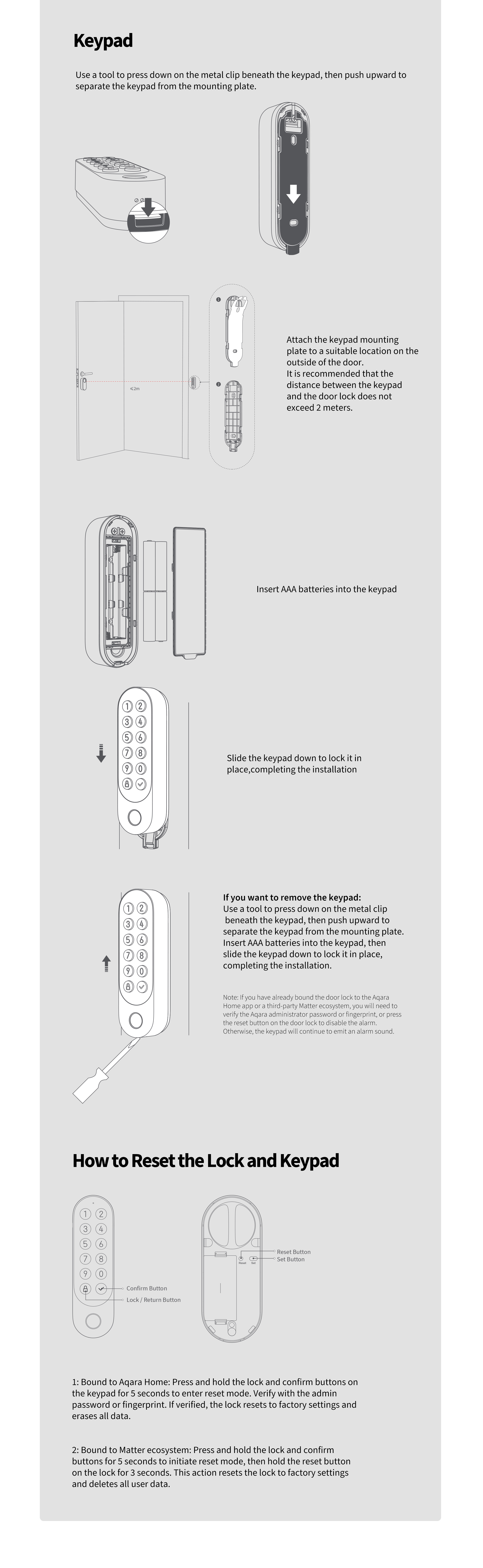

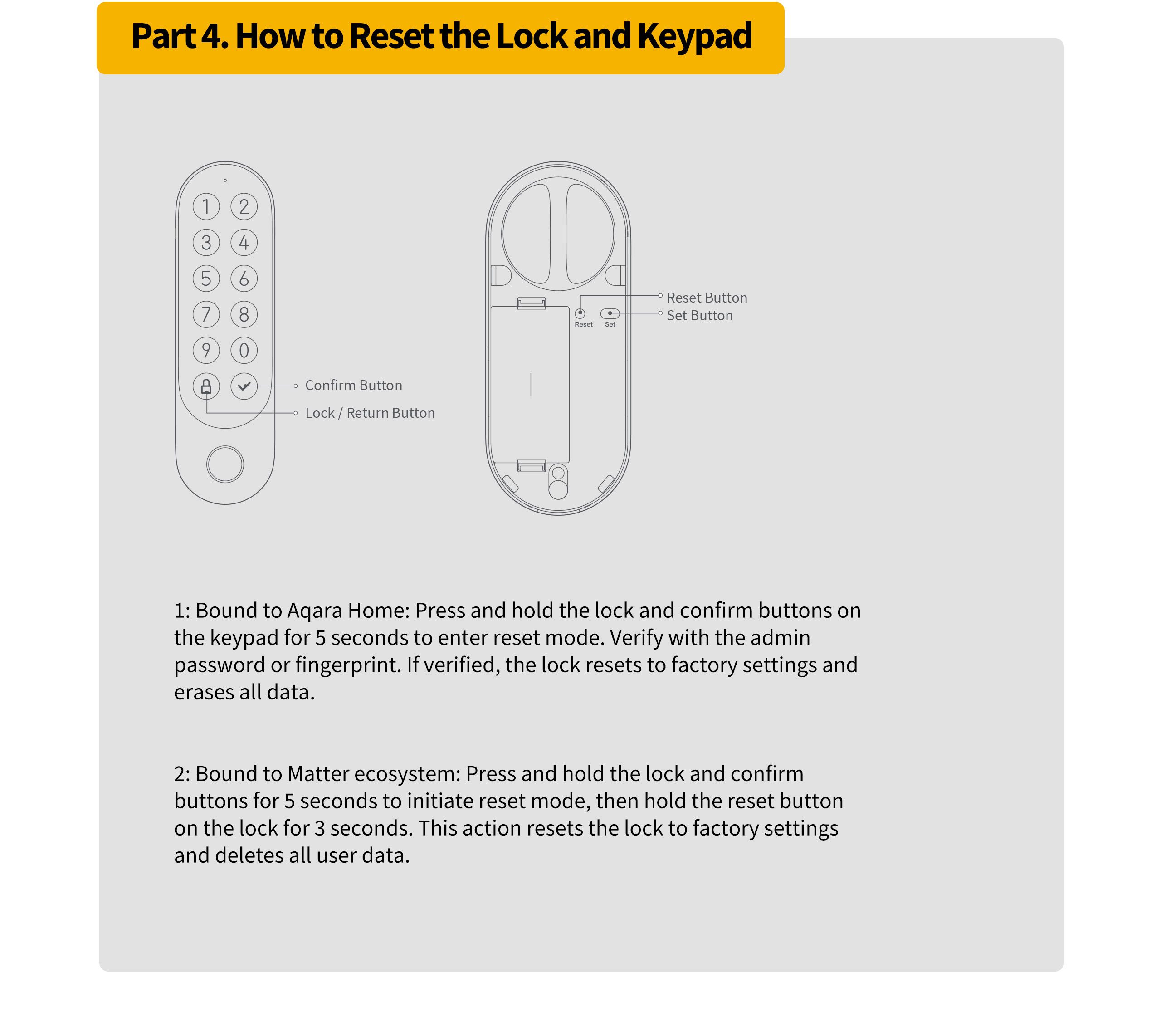

1) Aqara Home Users: Press and hold the Lock and Confirm buttons for 3 seconds. Verify the admin password or fingerprint. If correct, the lock will reset and clear all data.
2) Matter Users:
First ensure your lock is only bound to one Matter ecosystem; Initiate Reset Mode on the keypad by pressing the Lock and Confirm buttons for 5s simultaneously; Press and hold the Reset button on the lock for 3s.

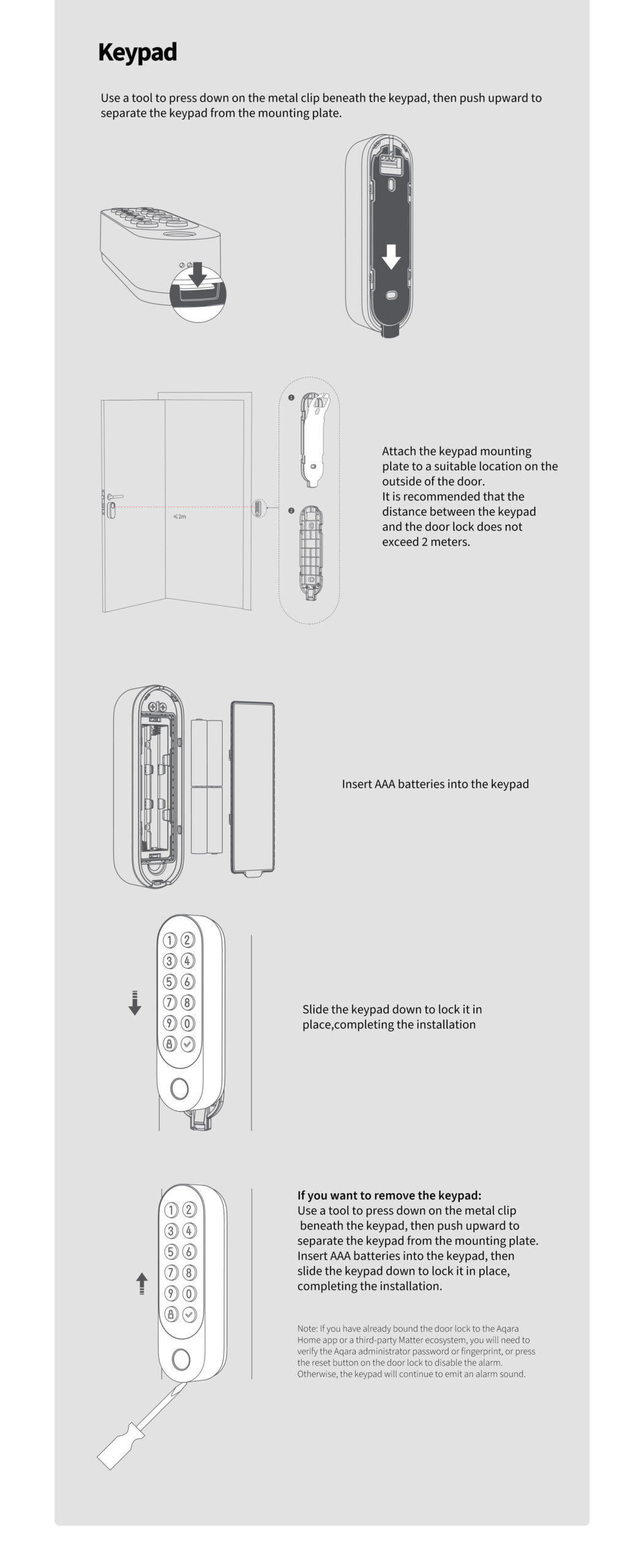

Power the keypad with a 12V-24V AC/DC 0.5A supply. A compatible transformer should be installed by a professional electrician.
